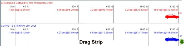

Using my model/simulator, my numbers are within margin of error to GMs
as to weather, elevation, rear wing size and GM uses a rolling 0 to 60 MPH number
For us number guys
I ran my simulator/model to bench compare a C7 ZR-1 to the new C8 ZR1, both with auto trannies
Here is the raw data results you can make graphs of
C7 ZR1C8 ZR1
Time to Speed Sec
0- 30 mph1.20.7
0- 45 mph1.71.3
0- 60 mph3.12.5
0- 80 mph5.14.1
0-125 mph9.57.7
0-150 mph13.510.5
0-170 mph17.613.1
0-195 mph26.518.1
Time to Distance Sec
0-60 ft1.81.4
@ mph46.646.1
0-120 ft2.62.2
@ mph55.355.8
0-600 ft6.86.2
@ mph101.6106.0
0-1320 ft10.910.1
@ mph134.3146.3
0-5000 ft25.823.5
@ mph193.2213.3
0-30000 ft103.795.5
@ mph223.7242.7
Top Speed mph224.0243.0
70- 90 mph Sec
2nd Gear
3rd Gear1.51.0
4th Gear1.91.3
5th Gear2.61.9
6th Gear3.72.7
7th Gear4.73.8
8th Gear7.15.4
90-120 mph Sec
2nd Gear
3rd Gear
4th Gear3.02.1
5th Gear4.12.9
6th Gear5.74.1
7th Gear7.35.9
8th Gear11.28.2
9th Gear
10th Gear
120-190 mph Sec
2nd Gear
3rd Gear
4th Gear
5th Gear
6th Gear18.011.4
7th Gear24.318.0
8th Gear51.929.5
