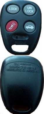

97-00 C5 key fob part No 19299230 wanted to replace my passive one on my FRC, I have two later model ones to trade part No 25695954 numbered one and two.
Or anyone who can identify the mercury switch on my passive fob as that helps to work properly apparently !

Does yours not have the passive slider switch as my 99 C5 has as below, which also shows the part number ?

Thanks for the reply, it's a 99 FRC, US car, we didn't get the FRC over here.
I have the same fob as your picture, same slider, same part No.
The fob pairs up fine and works as it should both in passive and manual but if you move it, around normally or shake it gently, it loses it's pairing until you pair it again.
The other two fobs are one I bought years ago and are for later cars I think, They don't pair and I just thought somebody might be interested in them for their car.
I didn't know you could alter settings via the drivers door memory switch, battery is new.
I read somewhere that the passive fobs have a mercury switch that causes problems, if I hold this one to my ear I can hear something sounds lose inside, I've taken it apart as there is a something rattling on the board but I can't pinpoint it. I also read that if the mercury switch is disconnected it can cure the unpairing.
The reason I was looking for a 97-2000 non passive fob was because I read that it is more reliable.

The mercury switch is top right hand in the picture, the round thing.

Looking at a quick compare of yours and mine, cannot see anything different or loose in mine
Yes, both of mine do that
That is what causes the FOB to wake up and with movement would auto lock/unlock the doors when passive is in ON position
Did you turn passive off and see how that reacts, but when it is turned off than the FOB buttons have to be used

part No 19299230​
I tried both on and off, I took it apart again and cleaned everything with acetone. I put a new battery in it which helped it relearn quicker.
I then relearned it and in passive it randomly locked/unlocked the car even when laying on the bench, with passive off it still randomly locked/unlocked and worked once with the buttons and then stopped, sometimes it reacted 10-15 seconds later !
I unsoldered the mercury switch, relearned the fob and so far it does what I ask of it, no random locks, unlocks.
We shall see how it goes but I still want another fob that's 1999 US spec compatible (part No 19299230)
Thanks again for you input.
This is my model with passive switch
