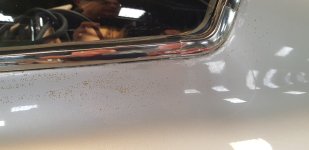

Can't help with removing the trim but a warning for leaving tape on for too long. This below was the split in the Spur collection that included the ZR2 we had on display at Corvettes at the Lakes just before it went back Stateside to be auctioned off. The split had been taped off around the front and rear glass for what I don't know but after leaving the tape on far too long this was the result around all windows..
