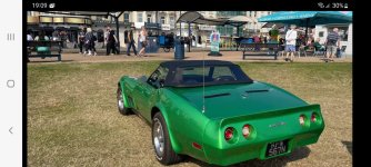

I have a c3 with a 5 speed borg Warner box conversion I'm told it's the t5 yesterday I got a loud knocking noise in 1st 2nd and 3rd gear but ok in 4th and 5th any advise would be greatly recieved as I know nothing about mechanics 馃槀
Slightly odd that it鈥檚 not doing it in 5th as well as it鈥檚 an overdrive and 4th is the direct drive. But I reckon you鈥檝e damaged the lay shaft (counter gear for out American friends)
Streaky72
Photo of your vette?
