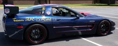

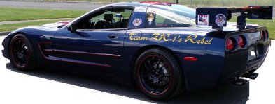

Ever consider instead to have them power coated ?
It handles the heat transfer from the brakes and holds up well and color does not bleed out
I did that 15 years ago for my C5, and they still look new
