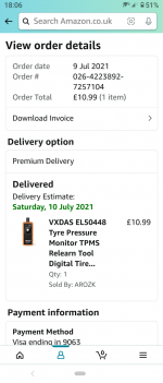

Did you actually buy a universal sensor and program it for a C6, or is the programmer you mention just the tool you need to relearn new (programed) sensors to the car?
Blackzed
Bought the programmer from Amazon, as per pic and bought the sensor from Autodoc as per the invoice.
