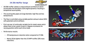

He says a flat-plane engine typically can produce an undesirable buzz sound that has to be minimized. The solution: two sets of exhaust tips next to each other in the middle of the car’s rear fascia. The resulting sound waves cancel each other out, eliminating the buzz.
The Z06 team also wanted to minimize what Link calls “air rush,” that jet engine–like tone usually caused by turbulence in a muffler with sharp angles. So, engineers designed a muffler with smoother bends and very short pipes.
Next, they expanded the pipe diameter of 2-3/4 inches to 3 inches. “That gives the sound waves more space and less back pressure to pass through a pipe,” Link says. The higher-pitched sound of a flat-plane V8 at higher engine speeds and, again, the Z06 redlines at an outrageous 8600 rpm is what this car shines at, and the team intently focused upon making the experience rewarding and memorable through sound.
Design done, the Z06 engineers turned to extensive testing and tweaking, including one last change to the exhaust’s internal baffle plates after team members noticed the sound “had lost some of its brilliance,” Link says.
