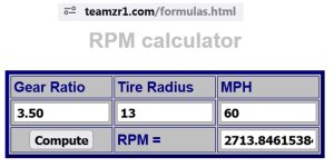

I suggest you verify what rear end diff ratio the car has and also tire wheel size as 2,700 RPMs just cruising at 60 MPH sounds
high if having like a 3.0x gear
Use my calculator and formulas on my website at
Cal & Formulas

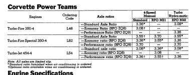

Match up your 1973 with the GM specs to see what gear ratio was stock ( not knowing if some owner changed it)
and then what the tire/wheel size is to calculate RPMs over MPH
