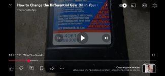

My C3 need a Diff lubricant, but it takes too long a delivery from US for the ACdelco, Is there an alternative that you can suggest to me?
cause these 2 main type...I found 85W-140 or 75W-90?
thank you!!

There’s a guy in the States called Gary Ramadei (GTR1999 on the Corvette forum) who is considered THE expert on C3 differentials.
His recommendation is a 90 weight mineral gear oil (any brand) with, and this is the important bit, GM AC Delco additive.
There are alternatives, but you never know how they will behave with the diff clutch pack, so I would just stick with the tried and tested GM additive.
You can get that additive easily in the UK, from our supporting vendors I expect or other online suppliers like John Wolfe Racing. You need two bottles.

Great! I had the additive, but I did not find a quick ACdelco 75w85 here in UK. I was not sure of the 2 different brand put together, oil+additive. This is good news, so I can use a any good 75w90 and put the right additive on top... Nice thank you guys!!!!

Yes, but put the additive in first then fill up with the oil.
