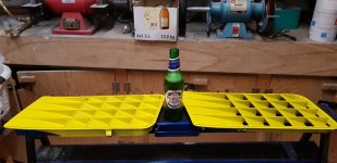

Two screws in the top and a set screw from below should keep them from rattling. These were some originals that I had just painted and shows the location of the three fixings.. the pin-stripe masking tape took for ever to apply over the chrome edges
