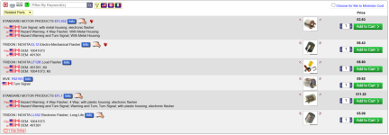

The original ones work by heat. You are better off fitting an electronic one then you can fit LED's or a mixture in the future.
Something like this:
