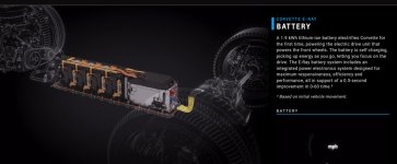

“This is not an energy storage device for a range EV,” said Holder. “It's all about, you know, enhancing performance, expanding the performance envelope, delivering it when the car asks for it and being at the ready all the time.”
The hybrid system inside the Corvette E-Ray shares nothing with GM’s broader Ultium program vehicles.
The battery itself is constructed of 80 pouch cells, which contain bespoke battery chemistry for the E-Ray platform. Holder likens the setup to a slow-moving capacitor more than a traditional hybrid battery. The batteries are mounted inside the car’s center tunnel section, as was intended from the outset of the C8 platform.
This helps keep the 100-pound battery in the center of the car, with the weight sitting as low to the ground as possible to cut down on any negative handling impacts. E-Ray buyers won’t plug the car in to charge, as the battery is topped up through driving alone. This can be done in little more than a mile of driving in the Charge+ mode.
The batteries work in tandem with a single electric motor mounted on the front axle. That part is also unique to the Corvette. This marks the first time that all-wheel drive has been brought to the Corvette platform. The motor case is compact and made from magnesium, while aluminum fasteners help keep things svelte. There’s even a miniature dry sump oiling system tucked inside the case.
The motor itself only weighs in at about 80 pounds, which is still enough to shift the weight distribution forward a single percent. The hybrid components all together add some 260 pounds to the car, according to Holder, with GM reporting a dry weight of 3774 pounds. Weight penalty aside, the E-Ray’s electric motor brings 160 horsepower and 125 lb-ft of torque to the equation. When combined with the naturally aspirated 6.2-liter V-8 out back, the Corvette E-Ray is ready with 655 hp and 595 lb-ft of torque.

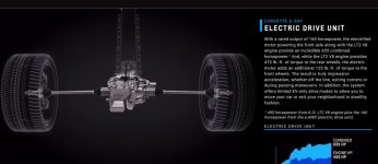

Planned from the C8 engineering program’s onset, E-Ray has a compact 160-hp (119 kW), 125-lb-ft (169 Nm) electric motor located between the front wheels, just beneath its front trunk.
A coupling attached to the motor’s output accommodates wheel speed differences in corners.
Rather than plugging in to charge the battery, the AC motor serves as a generator during deceleration and cruising to perform that function.
The 1.9 kWh lithium-ion battery pack, providing about 1/7th the energy of the battery in a 2023 Toyota Prius hybrid, resides in the 2.0-cu ft (56-L) cavity serving as the Corvette aluminum space frame’s backbone.
A power inverter is also located within that tunnel.
Electric assistance varies according to which of six drive modes is selected by the driver. Various data details, such as the AC motor’s instantaneous output, are available for display on cockpit instruments.
The standard Stingray’s 6.2-L LT2 V8 hammers E-Ray’s rear wheels with 495 hp (369 kW) and 470 lb-ft (637 Nm) through a carryover Tremec TR9080 8-speed dual-clutch transaxle.
