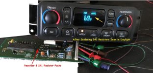

Here is an example of fixing this command failure point :
There are eight resistor packs, on top they say "241"
Over time due to heat the soldering joints from them crack causing lower voltage to the LCD screen

Turn over and look for eight resisters packs labeled 241
Use a low wattage soldering iron with thin solder
Re-solder both ends of each of the 8 resister packs, do not overheat them
Best is re-solder just one end of each and then let them cool a few minutes and then re solder the other ends
So that is 16 solder joint ends

Here is before and after re-soldering was done
NOTE :
To show this, I traced what each wiring pin was for and then temporarily hooked up voltages and ground to make the LCD screen viewable
Not something you need to do
