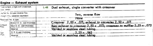

Exhaust, does not flow well at all since it has exhaust pipe for each head but than is shoved into 1 pipe to 1 CAT and then limited flow to mufflers
Here you see what the pipe size is
What type of headers you have, are they long in length, mid or short lengths ?
Best is, throw the CAT away, measure the diameter of the end of header where exhaust bolts to
If that collector is 2.5 inches than go same diameter for each side and run duals to 2 mufflers which have also 2.5" inlets
Your stock ones are limiting exhaust flow where the duels with headers will flow better and that helps make more HP and Tq

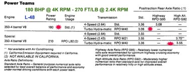

L-48 as you see has no balls and these numbers are at the flywheel
15% loss through drivetrain so by the rear wheels a VW can beat ya :)
With that auto tranny rear end ratio is only a 3.08 :-(
At least change that gear with the 3.55 the L82 came with will move the mass of the car better off a stoplight

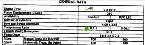

L-48 has only compression ratio of 8.5:1 (L82 had 9.0:1)
Could either replace stock head gaskets with thinner ones, will raise that a bit
or have someone mill the bottom of heads to raise compression up more
Add some timing, change jets in carb and then see ya at the drag strip :)
