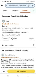

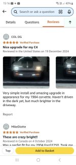

Thank you for the excellent replies, Steven, you link is extremely helpful, the standard headlights are H6054s and the ones on amazon are e marked and are supposed to be drop in replacements, I believe the only issue is with the fog lights as they earth through the main beam filament, so you can't use main beam and fog lights at the same time, so I may have to add an earth to the fog lights, I noticed on the amazon advert, that someone had installed them on an 1984 C4, I think i may purchase them and see what happens, my biggest concern was to ensure that they have an appropriate cut of in the beam pattern so they don't dazzle on coming drivers. I won't be using the DRL, indicator, or side light function, so the installation should be quite simple.

Looks good, but going from 55w to 180w is a significant increase in current without upgrading wiring.
It doesn't mention if the beam pattern is left or right hand drive. I assume left as that is what is shown on the pictures, so will you have to fit beam deflector stickers ?

I do like the look of the one in your link, but I don't think they are right hand drive so you will need beam deflectors and if one LED fails you will have to replace the whole unit, not one LED I have purchased from Amazon or eBay has lasted very long.
