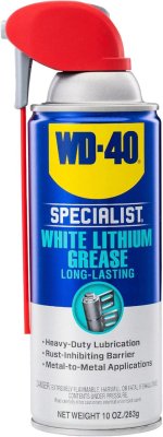

You could use this as good for window rails and gears
Amazon has it for like $7 US
WD-40 Specialist White Lithium Grease Spray​
  • Ideal for metal-to-metal applications that require heavy-duty lubrication and protection against rust and corrosion
  • Sprays on evenly as a liquid and sets dry with a thick, protective coating that won't run off. Safe from 0° F to 300° F for unbeatable protection
  • Perfect for auto hinges, gears, sprockets, latches, door tracks, pulleys, cables, and more
  • Excellent for lubricating equipment before placing in storage, and is 50-state VOC compliant
Or could buy it any place in paste form
