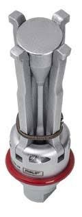

B49828CA-DF38-408D-B40B-A4B7863F2DF7.jpeg[ATTACHB49828CA-DF38-408D-B40B-A4B7863F2DF7.jpegB49828CA-DF38-408D-B40B-A4B7863F2DF7.jpeg=full]19384[/ATTACH] do you think this sykes pickavant expanding collet puller would do the same job? It say 30 to 50 mm any idea on the size of the shaft? Not sure if it is long enough?
I doubt it as I鈥檇 imagine it鈥檒l have a solid central expander so won鈥檛 go over the output shaft.
ah ! I wondered but the pic doesnt show the inside. I did find one in the usa but 260 dollars plus shipping. Will keep looking . Most said discontinued, I bet there are loads unused in peoples garages over there馃槱
