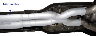

As to an X-pipe, it depends on if you're doing so for sound changes or for a performance gain
I did a very lengthy design and long term testing of size, shape, sound in Dba, and best location using my C5 you can read up on
via my website at :
The X-pipe was swapped in this case in place of the CATs
