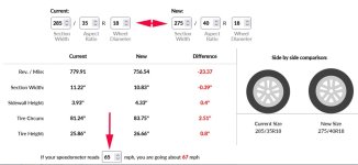

There will be others on here that perhaps will have suggestions - I have Toyo Proxes 285 40 18 Y or Z on the rear of my C3. That size is getting rarer and more expensive now and I'll probably have to shift to a 275 size in future.
can you get 275 size without new rims? Probably a dumb question but im genuinely clueless, lol.
Most wheel rims have a small degree tolerance re. rim size vs tyre width. It will make a very small difference in tyre diameter/rolling circumferencer The difference in width between 275 and 285mm is a mere 10mm - fractionally smaller in diameter too.
