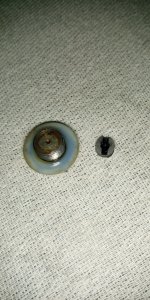

I agree, no way would that be a GM part
Looks like that weak magnet was glued on and lucky it did not somehow get caught on the inlet of the oil pump
View attachment 24848View attachment 24849
