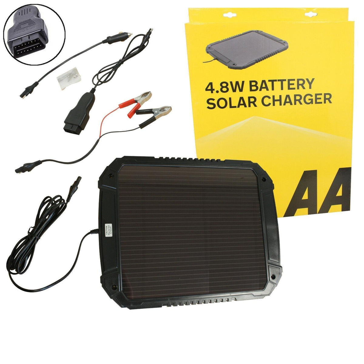

Cant comment about Optima batteries but this is the solar charger we use. Its been used to keep the battery on our horsebox topped up as its not used regularly and too big for a garage. We've had it for three or fur years and its worked well and is left on the dashboard facing the sun. We connect it to the USB port but it comes with connectors to the cigarette lighter or direct to the battery terminals.
