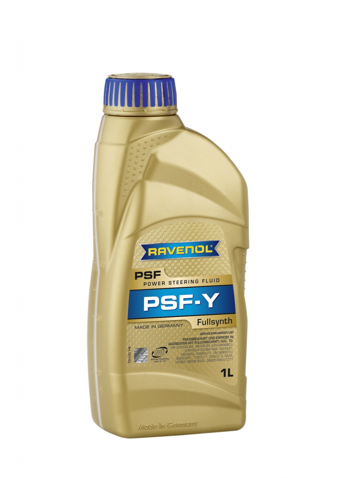

When I did my C4 I removed as much oil from the reservoir as possible and filled it with the new oil, then removed the return pipe to the reservoir and put that into a container and with the front of the car on axle stands got someone to turn the wheels lock to lock until the new fluid was coming out.
This oil is also compatible:

Hi Steve, yes that’s pretty much how the guy on YouTube did it. He started out by saying his 4L should be more than enough but eventually he had to buy another due to the old fluid still evident. It could work out an expensive exercise if I use 6-7L. I suppose I have to weigh the cost of the fluid against a potential full seal replacement on the whole system which could be a PITA😂
The Westway fluid is cheaper though and it does have that GM 9985010 spec though

So long as it meets the GM spec it should be fine, and cheaper is a bonus.
