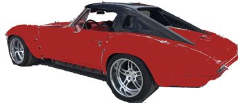

Often wondered what a C2 coupe would look like with T-Tops? Never seen one done and Iā€™ve been to lots of corvette shows stateside. Iā€™m quite sure someone has done one somewhere in the US, especially during the custom craze of the 70ā€™s
not quite.......
In my eyes it doesn't quite work - rear sloping butresses arguably look too heavy and need to be a little 'slimmer', perhaps tapering down to the rear deck with a gentle concave curve to blend with the opposite and convex curving of the rear end.
