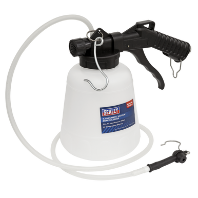

Can anyone suggest a decent and effective brake bleeding kit for my 1970 corvette, any tips welcome as the system is empty of fluid at the moment after a rebuild and this is the first time I have done this job.

You’re a bit stuck with the C3 master cylinder limiting you to a suction type. If you’ve got a compressor there’s a load of options. If you haven’t most of the hand operated suction types are hard work but I have used a Mityvac one successfully. It is easier to get a mate and do it the old fashioned way.

Did you need to bench fill the master cylinder first using this or can you just keep topping it up the master cylinder in place with fluid until brakes are firm?
As I did remove the master cylinder during a rebuild its now back in place but dry of fluid.
Not used it on the Vette yet.
But have used it on lots of rebuilds and never had to bench fill. Usually I find you have to go round a couple of times from dry and press the pedal every now and again.
The only trouble I’ve ever had was a Kawasaki where the bleed nipple on the caliper wasn’t at the top so it kept a bit of air in it.
