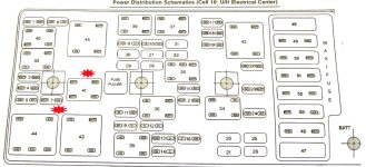

You could try and pull fuse 7 in the fuse panel in engine bay or relay 41 which both are for the damping system
Or pry apart the ground splice pack 400 at rear and check all male and female ground pins

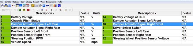

If wanting to debug and have a decent scanner or Tech-II look at the functions and see what they report like this
Or if wanting to debug and fix using the GM service manuals for the C5s
Start with book 1, section 3 and starts at page 142, all everything about the ESC and shocks for F45 is there including the wiring and each wheels shocks DTC and how to debug
