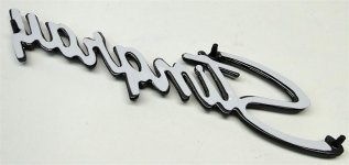

Hi guys a quick one, there is any difference between a 1969-73 and a 1974-76 version, for me looks the same!! Cause I found the right metal version but the label says 1969-73. But they looks the same my broken ones. Any suggestions?

The difference was in the mounting pins. The early ones had 4 mounting pins and the later ones 3. Check the holes in your fender to see what ones were fitted.
Here’s both from behind
4 pin is 1969-73
3 pin is 1974-76
Actual script “stingray” is the same for both, only the pins are different
Looks like if you chopped the middle pin off from the 4 pin badge, then it'd be the same as the 3 pin badge. The 3 outer edge pins on both the 4 and 3 pin badges seem to be in roughly the same place.
That I think will work, chop the one off on the g. A tiny bit of double sided tape and you’re all done.
I think the replacements come with double sided already on.
