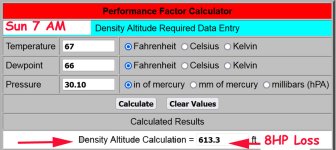

I have been working with Bob on this but including how a vehicle performs as to the effects of weather and elevation
He was getting 0-60 MPH times of 3.2 seconds but as of today down to flat 3 seconds
WE did that by calculating the corrected Density, which affects how the engine performs
Bob getting 3.2 seconds if we look for the Corrected D/A we see that the time he did those 0-60 MPH runs
even though he lives at about 500 feet elevation, the weather made it as he was at 2,295 feet
This reduced HP by 30
Now he waited, and we looked at the hourly weather numbers and say for today that at 7 AM and the corrected D/A was only 600 feet and engine only lost 8 HP and thus 0–60 time 6% quicker of 3 seconds
Now what we want is good weather where the corrected D/A has a minus elevation but will not be easy as he lives in Florida
