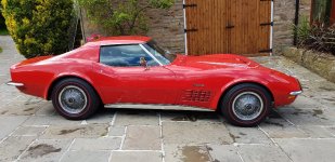

215/70/15 front 225/70/15 rear, 71 Corvette. I find the taller wall (70) than typical (60) fills the opening better and removes some of the stock 4x4 look. That and a slight lowering helps too.

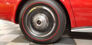

I went with Redlines as I was sick to farkin death of trying to keep the RWL white/clean with little success.
Gone back to the Derby Caps & Beauty Rings now too

Looking great, good choice on the caps and rings too imo, I had the po2’s but always niggled me that they were not quite as perfect as the vaps and rings

I quite like the look of the PO2's but they're a lot heavier than the poverty caps. Those in the pic above I restored and converted from Impala covers and are now wall hangers. I came across a set that had billet aluminium centres that were/are perfect and had to have them so I ran with them for a couple of years before taking them off..

Love those redlines with the red paint 👍

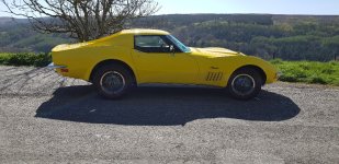

There you go
Before the redlines..
The yellow one was stock height but with the same size tyres as the red one which you can see with the distance from the top of the tyre to the wheel arch lip:
