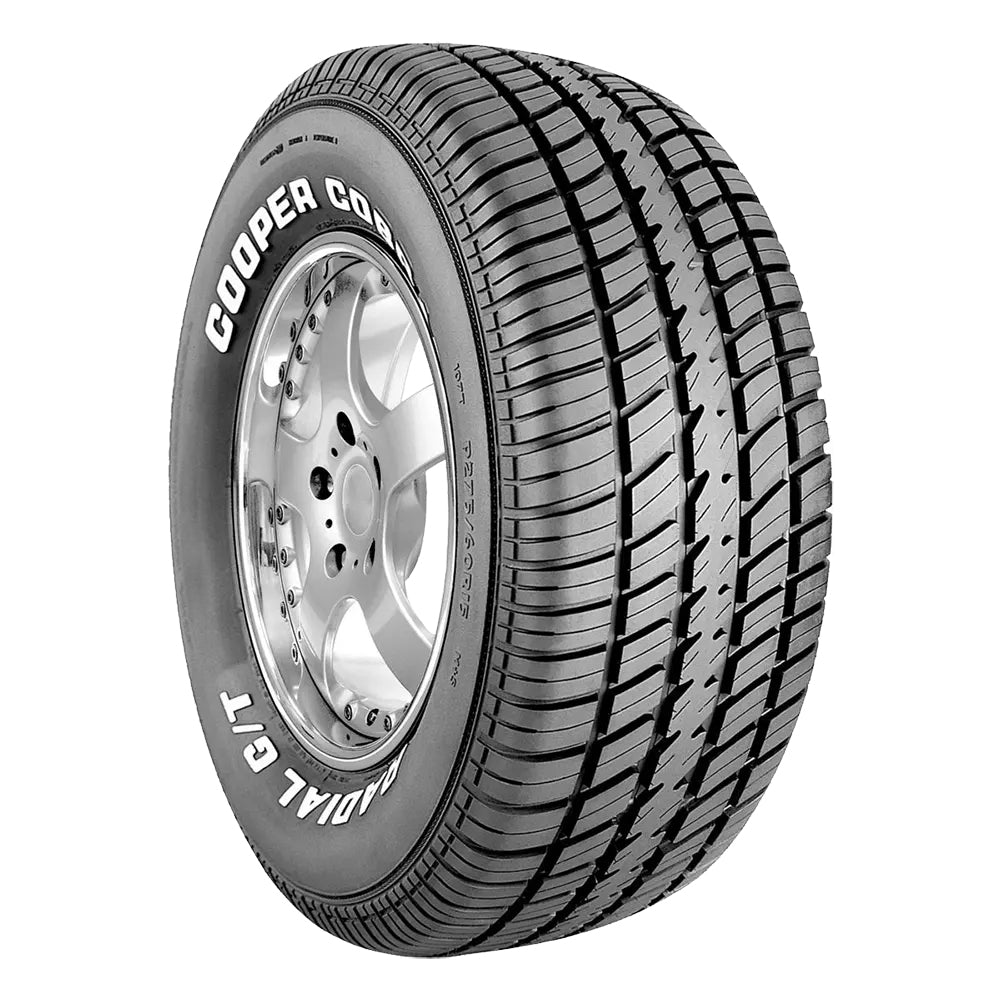

I've had the '74 since 2004 and when I got it, it had new-ish Cooper Cobras on each corner - still on original steel wheels.
20 years later - I figure I ought to change the rubber - loads of tread left, but for safety's sake......

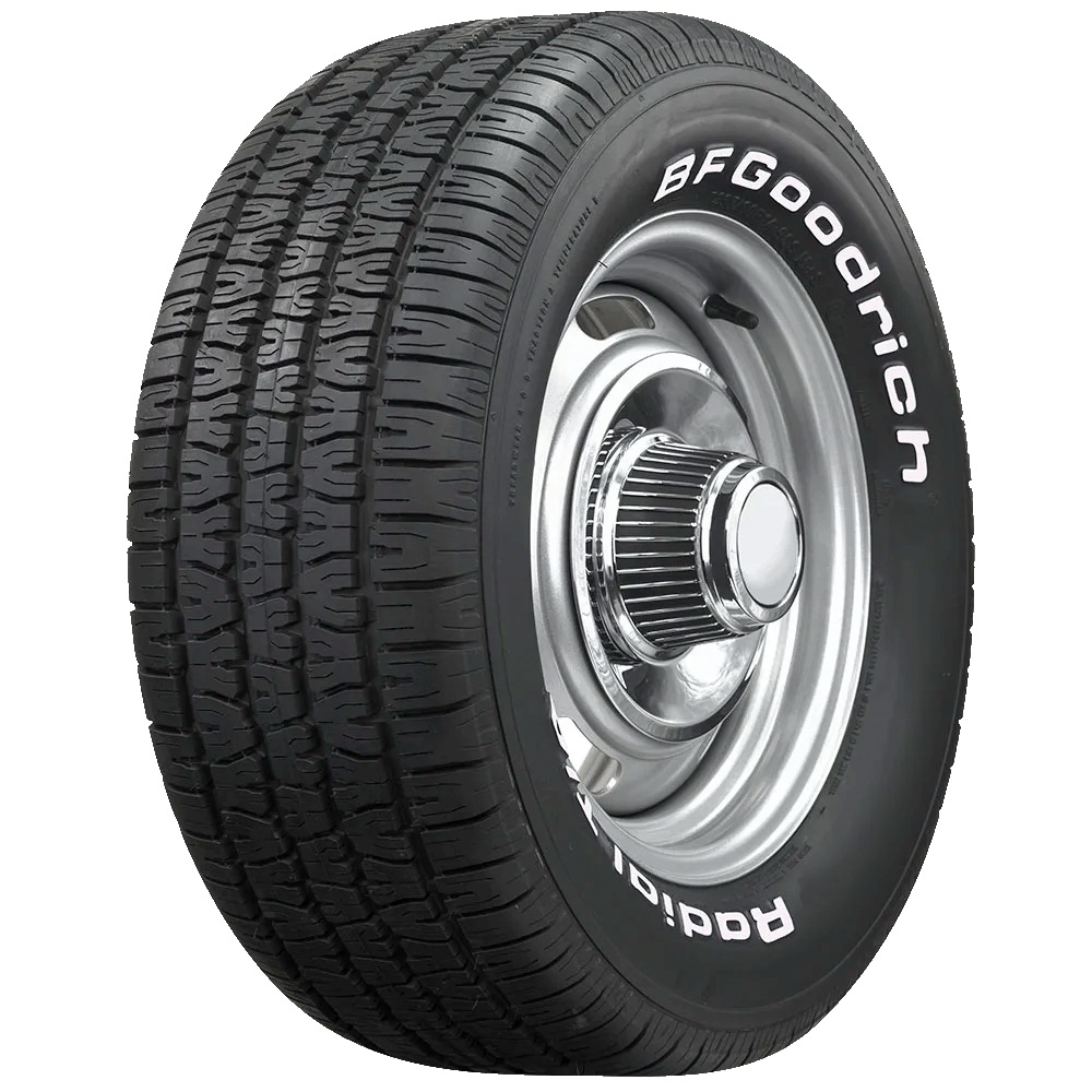

Or BF Goodrich (£187):

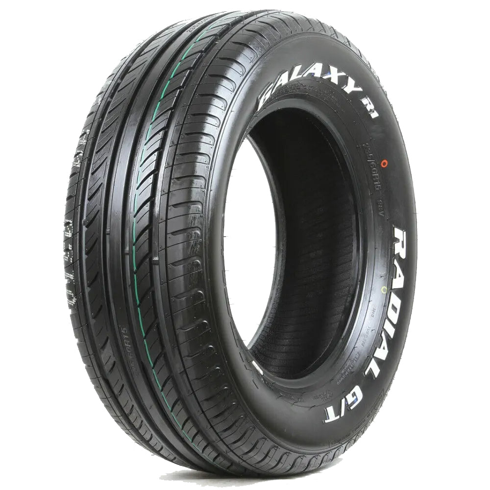

Galaxy R1s (£128):
I've never heard of the Galaxys and haven't seen them on anyone's car (not been to a show for at least 5 years).
So are they any good? Clearly a saving when doing all 4!

You need to have a chat with Andy Maskery, Essex Rep. He has the Galaxy tyres fitted on his modified '76. An ideal person to ask/discuss as he has used them on his car for organised track events at North Weald. You'll presumably know the Galaxy's have a far higher speed rating than Coopers, Goodrich and any other alternatives. Not making any presumptions that you'll ever reach the heady heights of 149 mph (or what ever the rating is)........but I would be more comfortable knowing the tyre has been tested at higher speeds........remembering that C3 sized tyres in design terms are over 50 years old.............
I would also try speaking with members that have bought RWL tyres in the last few years and see if the Blooming issue is still with them. I bought a full set of RWL BFG's that turned brown sat in the garage. Nothing I did could get them white again and research led to new environmental restrictions changed how the tyres are made resulting in oil leaching out turning the letters brown. It didn't help that the tried and trusted treatments for keeping them white such as Bleche White and others have changed their formula again due to environmental controls making them lest potent. I switched to relines on my C3 and very happy with the look and not having to spend hours fruitlessly trying to get RWL white again.
Another based on a mistake I made. Always check when the tyres you are purchasing were manufactured (DOT code on the tyre wall) as tyres such as RWL, white line, redline etc can sit unsold for some time and even years. A set of redlines I bought in 2019 were made in 2016.

My experience with BFG's was that the older they became, the harder the rubber seemed to become (and would they ever wear out?), the less they gripped but inversely the more they would 'squeal' when cornering at anything over 10 mph!

I bought a set of 215/70R15 BFG RWL's last year to replace very aged but relatively unworn Goodyear Eagle's on my '71. Four tires cost me £607 inc. VAT.
I've had no problem with browning but normal road dirt is very easily cleaned off with this....

As Ross says, I‘ve got the Galaxy tyres on my car (225/70R15) and I’ve been happy with them. Performance wise they’re fine for spirited driving. I’ve not tried BFG or Coopers so wouldn't know if they’re any better or worse, but Galaxy does have a higher speed rating, if that’s an indicator of overall performance.
The tread pattern is a more modern design than the block tread pattern of BFG, ie has continuous centre bands, but doesn’t look too leary or out of place on a classic car IMO.
I got the tyres in about 2019 I think it was, and they had only just been launched by Northants tyres. The lettering did turn brown. Its possible to clean them up a bit but not back to gleaming white. (I’m not too bothered about that - my car is a driver rather than show car, there’s usually brake dust covering the lettering!). I‘m seeing quite a few people with Galaxy tyres now and can’t say I’ve noticed or heard any complaints about browning. I wonder if the manufacturers have found a way to prevent it now. I’m sure at one time there was actually a statement on the Northants website about the problem, but I can’t find that now, so maybe it’s resolved.
