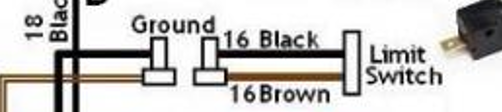

But if anyone has any ideas what the bits on this wiring diagram is that'd be great - i.e. the ground wire from the "over ride switch" (bottom right) goes up to a upside down "T" shape thing in the top left corner, next to the firewall limit switch bit (I know where that is in the engine bay, and in the 1968 only that only ever has ground through it 0 69 onwards its positive). But what does the symbol mean? And what is the component? Unhelpfully it then leads that to another symbol just below it that looks like "Stone henge". What component is that? :ROFLMAO: Both of those black wires from "Upside down T" and "Stone Henge" both go to the override lamp you see, which illuminates when it gets 12 volts. So evidently 12v is now going down it from somewhere. If it helps, its from a permanent live - turns on when I reconnect car battery (normally disconnected).

And the schematic is confusing and not sure if it is correct
I assume what you mean by upside down T at top left is the connections to the limit switch
Do not know what "Stone henge" means but if you mean right below limit connections
I think that means where the relay shown on right connections
Look at the blue arrows I inserted and as to the notes at bottom follow the black stars I inserted
I made the black and blown lines for override wider to easier to follow those wires

This bit is the "Upside down T" below the word "Ground":
I can see that the "Upside down T" on the right is for the Firewall Limit Switch (which is ground based on a 1968), but didn't know what the left hand side "Upside Down T" was.
By "Stonehenge", I'm referring to these that are just below the bit above:
I can't work out what actual physical component that was supposed to be representing, and more to the point where that component is.
But looking at the diagram again after your labelling has made me realise the blimmin obvious wording at the bottom that says "If the ground has fallen off the override switch bracket then the override lamp will illuminate". So that's probably a good thing to check. And there I was trying to focus on the components in the diagram and what I might have upset when wiggling wires around, and missed the obvious text at the bottom.

Maybe the T and hinge is terminal blocks on the firewall that the wires connect to ?
Or is where relay is wired to ?
In any case take an Ohm meter and one of the probes connect to the over-ride switch shown at bottom right
and other probe to the brown/white wire at one side of the limit switch and make sure that wire is good
Take one side of OHM meter to one side of the limit switch and other probe to the other side of the switch and see what the meter shows and then press the button on top of the switch and see if that works correctly
With key on, engine off, when you press down on limit switch does the over-ride light go on and off ?
Does the 12 volts using a multi meter for D/C voltage show 12 volts when the limit button is pushed and then no light when not pressing the limit switch button ?
