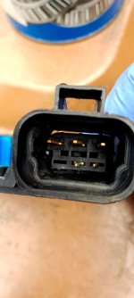

That's right... the connector itself has huge gaps that would easily let water in 🤦‍♂️
Not forgetting that the connector itself is the first that's hit for water dripping off the windscreen cowl.

The rubber is there but given the age of the car, I can only assume it doesn't seal its best.
You can see one connector pin that started to corrode a little in the picture above so evident that some water has somehow made its way through.

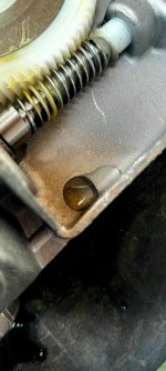

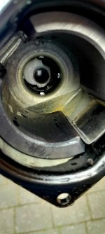

I took the motor off the car and as soon as I opened it... again! another motor full of water!!!
I cleaned the entire motor out with WD40 (as a water dispersal), brake cleaner (to get rid of contaminants and any WD40) and used compressed air to dry it out.
I then put a LOT of ACF50 inside the unit and also did a more thorough job of resealing the unit with 'WURTH Super RTV Silicone Sealant'... then squirted a load more ACF50 through the connector block (just to be double sure 😂).
Fitted it all back to the car and the wipers are working perfect again 😊😊😊
Hopefully this will be the end of the issue 🤞😬🤞 but only time will tell I suppose.
Again, I couldn't find any reason as to why the motor got water in? 🤷‍♂️
It has the rubber cover/skirt covering the motor itself, including a rubber boot/seal on the motor shaft. All 3 udders are fitted correctly, clean and free of any debris. All in perfect condition also.
So it really is a puzzling one as to why I've had this happen 3 times in only 6 months? 🤷‍♂️
