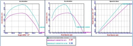

Clone a 1973, using a model/simulator
(A) EXCEPT one has a 2.87 final gear
& other has a 3.55 final gear (B)
Time & Distance V MPH

I will try it this way
This is using the 700R4 gear ratios but using a 3.55 rear diff gear with max 6,000 RPMs (bit lower in 3rd/4th gears)
So first gear can get to 44 MPH (as shown below)
2nd - 80 MPH
3rd - 123 MPH and
4th, if going 37,000 feet distance - 141 MPH (stock engine)
Changes to above depends on elevation, weather and road surface conditions
You can see of course that first gear produces the most torque
Any tranny and/or gear changes and wheel and/or tire sizes will cause incorrect speedo values
and corrected by either gear at end of speedo cable at tranny and/or inner gear in tranny
kits are sold to do this
