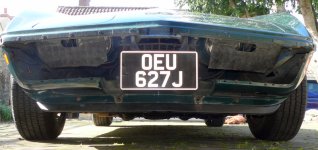

My cold, damp garage is an uninviting place to spend much time at this time of year but the recent mild spell has finally encouraged me to get the replated front end chrome back on the car .....
Before.....

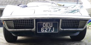

....Stripped down.....

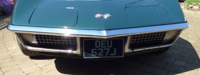

......and after.
The lighting conditions at different times of year make it difficult to get a good photographic comparison of the chrome before and after. The bumper was not in really bad shape before rechroming; surface speckling rather than any serious corrosion, but I have to say the new chrome really draws the eye and lifts the whole appearance of the car.
Before refitting I coated the back of the bumper and under-riders with a liberal coating of my favourite rust preventitive, Krown T40 and with everything loosely fitted and a lot of fiddling I've managed to reduce the uneven gaps between the lamp units and the under-riders that seem to characterise many early C3's. There are still gaps but they're reduced and more balanced than before; More fiddling may reduce them further but at the moment my patience is exhausted.
Was it worth the cost? As I say, the chrome wasn't that bad before replating but the difference in appearance of the car - to my eyes at least - is quite striking.
