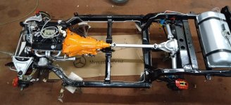

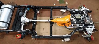

Got around to finally fitting the uj's to the prop and got it fitted. Rear beam stripped painted and fitted, chassis has all been waxoyled now and a few smaller Jobs finished so last pics of the chassis before I get around to popping the body on. (When I get the chance) 馃槉
Ooh ! that`s lovely . Almost a shame to cover it up with bodywork . :LOL:
