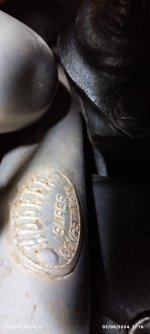

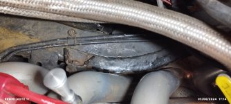

Hi John - took these images earlier of the headers on mine - they are Hooker Super Comps with 2 1/8" OD primaries. Driver side is a poor photo but clearance of header pipes to steering box is the same as the passenger side - minimum of 1/8". Close enough to cook the paint on the chassis rail........but using Poly engine mounts (rather than stock) they do not touch anything and there are no adverse issues......in fact they 'sharpen-up' the gear shift. The stock rubber based engine mounts allow too much lateral movment of the engine/transmission combo......possibly affecting quality of gear shifting.

That's awesome, thank you.
