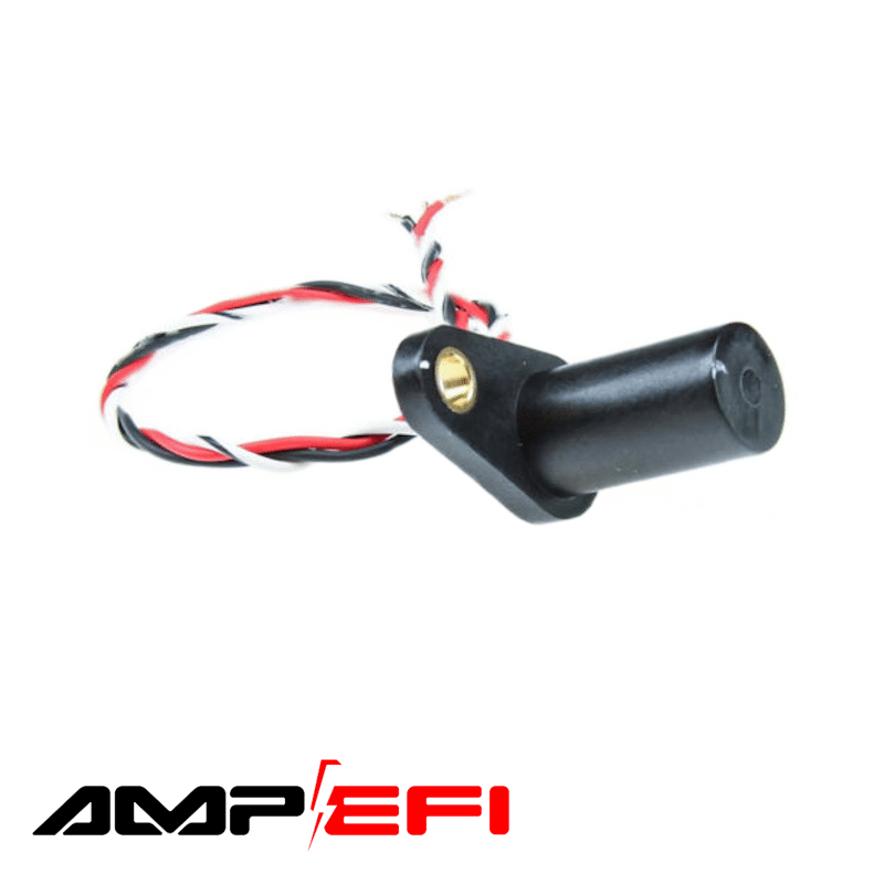

Thanks, that's really helpful! I've emailed them to ask if they have physical stock - I've found in the past that alot of parts suppliers list 100s of items thinking they've got a supplier and it's only when an order is placed that they find out it's NLA.... The actual sensor I need is 10096172 but I think 10137658 would do the same job from what I've read up on. There is a generic one you can use but it needs a sleeve of a very specific diameter and needs to have the connector re-pinned... I'd buy one immediately but the chap who sells them is hard to get hold of!
Llewelyn
As you might have seen (?) says in here that if you use 10137658 instead of 10096172, you also need the "shield" part (whatever that is/does?)
Yep - The shield is just a small metal plate that I think acts as a heat shield due to proximity of the manifold... Looking at it I am sure it could be modified to fit without too much effort!
Shame people would spend like $200-300 for a sensor can be bought for $38 US
This has been used for many years as a 3rd party one for ZR-1 LT-5 that just needs the wiring connector added
Llewelyn
Thanks - I have seen those, as I understand it needs an additional sleeve fitting because it’s not the right diameter? I’m wondering if an o ring at the base of the shaft would work just as well. I might just buy one and see how it fits!
My understanding is guys using this CPS when using an O-ring say it is a tight fit but twisting sensor when pushing in and will fit
Should be if need be to make a way to heat shield
