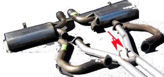

I mentioned this back in post #3 and is a well known issue
As you see with my C5 in the stock mid-pipe next to the H pipe you see the 2 brackets
You could silicon spray those and also look at the hangers of mufflers and look at the rubber grommets and silicon those where you're at it
Re torque any bolts or hangers
Notice the muffler hangers sticking up the rear of mufflers in my image
