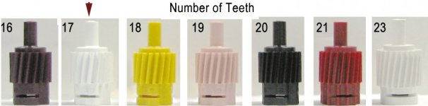

You could use a GPS unit that also shows speed and at certain speeds like 40 MPH compare what the speedo on dash shows and what GPS says and see what the percentage difference is
Then do the math to see which inner or outer gears are needed to correct or try this :
Speedometer Gear Calculation
Speedo Revs/mile = (20168 x DiffGear x DriveGearTeeth) divided by (Tire-diameter x Driven-GearTeeth)
Or here is another speedo gear calibration calculator
Calculate Speedo Gears
Thanks for your help. I’ll see if I can get a 17 tooth driven gear, that should get me nearer correct.
