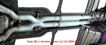

When I designed the exhaust system for my 1999 C5 in 2009 I used these, and they still are about the same Dba level now
These were the real business back in the day. Various tube diameters. Two lengths, short case ('kin loud) - long case (not quite so loud). Packing may have been steel wool, perhaps glass fibre. They had clever system called 'Turn 'O' Lock' or something similar where the end plates were convex. The ideal being that if you needed the inlet or outlet stub to be at as slight angle to help line the pipes and muffler up you could insert a short lengthof exhaust pipe in either (or both) stubs and lever it over a few degrees. The convex end plate would effective 'lock' and permanently 'set' the stubs at the required angles.......great bit of kit!
