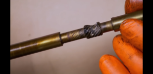

Hi Nigel, I recall seeing an episode of Wheeler Dealers, where the distributor drive cog teeth on the end of the shaft were partially worn away, causing rough running. Admittedly it was a C2 but basically the same.
