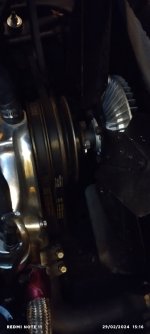

As seen no belt off the crank pulley for A/C and do not see any Freon lines or compressor, unless not in view of this photo
I suspect Upgraded cooling system, means the engine coolant system as would be needed with the engine mods to 6.5 liter
Certain early C3's that 'did not' have a/c still had a dual pulley which came with a redundant 'slot'/1709220012624.jpg
