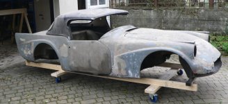

Some years ago I made a wooden trolley from 2"x4" timber to move a car body around during restoration....

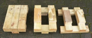

With the resto completed I chopped up the trolley to make cribbing blocks. These were made in three layers......
The top and bottom assembled together give a 7" height and with the middle layer inserted the height is 11".
Assembled the layers are fully interlocked to prevent any movement when supporting the car. Jacking to get wheels up to a foot off the ground with the suspension dropped requires a longer stroke jack than I have so the split levels allow the jacking to be done in two stages if necessary. Cribs are particularly useful when you need to work on suspension in the fully loaded condition - tightening up nuts and bolts after replacing parts for example.

Nice job, I like the 3rd layer . May add them . On another point , the daimler dart , some love them but I always wondered , being the sixties whether the stylist should have laid off the Wild Woodbines a bit more. 🤣🤣
