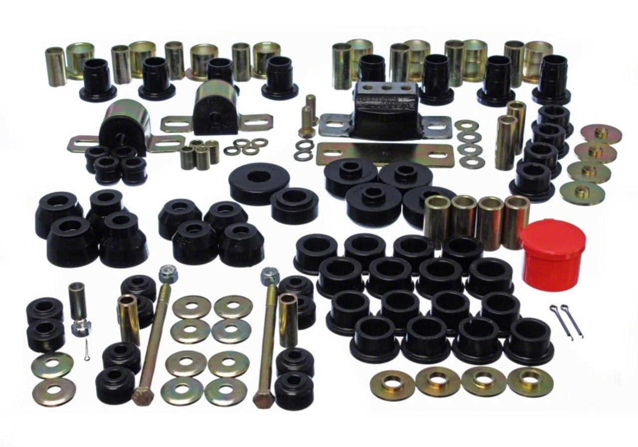

How about these is a complete set ?
Or
Waynio
Or
I found them a while ago but it seems poly is no good at all.
I see nothing in that ad that they are poly
specs do not say poly

Hyper Flex is Polyurethane. Just there name for it.

I remember you mentioning that before, well i think it was yourself as you mentioned the grease then.
I have not yet seen a review on problems with Energy Poly kits. I am thinking it could be the time when a lot of dodgy poly bushes were going about and has put a lot of folk off them.
