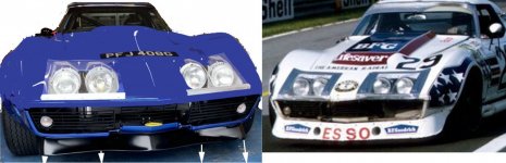

Maybe the angle of photo, but looks like air would get under and create lift at speed.
I tend to go lower in front spoiler but because of running higher speeds be
Brake cooler hoses to the outer edges and used center to flow colder air in for radiator and intake air

Maybe could go a bit lower but there a 100mm min ground clearance rule. This is early ‘70s even prototypes and CanAm didn’t run all that low then.
