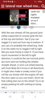

You are always going to get some movement.Hello people. I've now replaced the wheel bearing on the drivers side. I did this because the M.O.T guys said there was movement of the rear wheel side to side and said when they pulled it. They said it was likely the wheel bearings. Despite having replaced this, I'm still getting that fractional side to side movement. This forum (attached) seems to suggest that replacing the "toe rod end joints" would sort that or be the bextvthing to try
Please can someone tell me if that might solve the problem and if so the GM part for that. (and a picture of what I'm looking for please) is it a big expensive part or just rubber bushe
