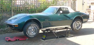

.....I take advantage of the sunshine and moved my QuickJack outside to hoist the car off the ground.

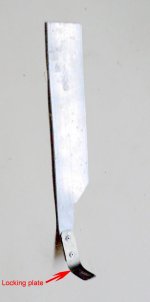

Before putting it all back together I have to lock the shift with a locking plate to ensure the movement from the 1-2 shift line to the 3-4 is unimpaired. This is done by inserting a thin 5/8" wide plate into the side of the shifter, which without removal of a lot of parts to allow access, is practically impossible from underneath.
So, back inside the car I still can't see the slot to fit the setting gauge but with a bit of ingenuity think I should be able to 'feel' it. I rivet the plate to a length of aluminium strip and bend it sideways .....
Sliding this down the left side of the shift arm a bit of fiddling allows me to insert the plate and lock the shifter in the neutral position
