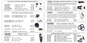

Don't you love the sound of an engine being revved out on a dyno - shame you never hear that sound in the car. IF the dissy is still has a stock advance curve you should be able to source an advance curve kit from someone like Real Steel (see below). They normally come with three sets of springs and three sets of bob weights. the lightest springs and heaviest bob weights obviously get the advance comming-in and maximising at a lower rpm. TBH I be surprised if previous owner didn't sort something out here.
