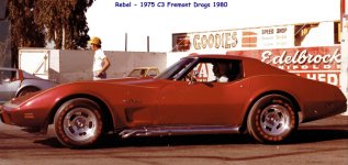

Oneball, were you able to solve and get the sound level down ?
Wish I could recall back in the late 1970s I had found a way to get sound level down on the hooker headers I used in my 1975 C3
