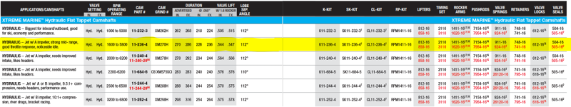

I'd be inclined to pop 'em over an email explaining you have a 8.5 c/r 454 Vette - stock heads - stock exhaust - Holley DP 'xxx' CFM - LS6 inlet - 'xxx' rear end ratio - 'xxx' gear box (so M20 or M21) - expain your useage and see what they suggest.Taking on board the comments about low compression and RV cams, should I also be considering the Xteme 4x4 range or have I misunderstood this.
