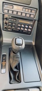

One of the first little jobs I took on was replacing the gear stick head and boot.
I say little job but it took me about half a day to remove the old gear stick head and I literally punch my self in the face when I broke free.

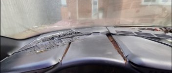

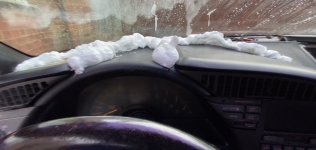

When I got the car, the dash was destroyed! Completely melted by the vegas sun.
I originally saw this s something I may have to live with as importing a new dash over from the US would of near enough cost me about the same as shipping a car over because the 1990 dash is one big piece unlike the older models which are made up of a few small parts.
so with no hope of getting a replacement I got creative with repairing the one I had with foam filler and then panel filler, sanding down to a smooth finish then painting it, then after all that I ordered a dash cover anyway and covered the eye saw up 😂
